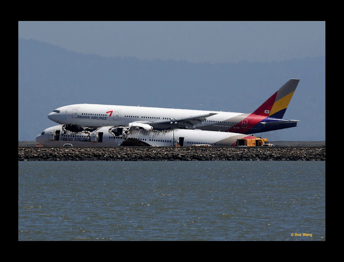

BOg1QPuCEAA8spW.jpg:large
Acest moment e si mai dramatic.
BOuI30bCEAEw2M1.gif:large
